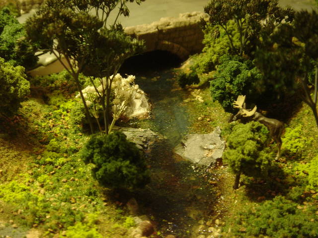

If you look back at all the pictures, you’ll see something no one has mentioned - the vegetation along the shores. This is really a key item. Not only does it hide the edges, it also provides something which reflects off the smooth surface. I like to apply tall grass and other foliage after the Envirotex is set. It does like to “creep” up the edges of the water surface, so I can hide that with other scenic materials later. Overhanging trees have a nice appearance, too.
My thoughts on blue water.Water is gloss medium over a mix of Cobalt Blue,Black,with a touch of Thicket a greenish colour.This is my version of the Grand river which splits my home town (Grand Rapids) in half.The normal colour of the Grand is NOT a colour I want on my layout.
This area is still very much under construction so the photo took a quick trip through paint.
