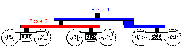

Let me try to illustrate how the two span bolsters are used to support flat car. See the attached diagram.
Span bolster 2 is connected to the flat car and also span bolster 1. This way the weight of the flat car is spread over all six axles.

Tom,
Great picture, and it matches at least one of the TTX cars on your site (I use it a lot actually), but is that the same for the KRL (Kasgro) cars? Looking at the photos you have, the photos I have, and the diagram from your site, I don’t see where there is room under the car for 2 span bolsters on each end. All the data seems to point to 1 of 3 choices.
  1. The span bolster is the length of all 3 sets of trucks, 2 of the trucks pivot normally, and the third has a different “mounting” that will allow it to move laterally in a curve. Baldwin did something similar when they built an experimental turbine (shown in the back of MR’s Diesel Locomotive Cyclopedia). Instead of span bolsters between them, the outboard trucks could just move around more than normal.
  2. My thought on this is that the span bolsters meet and pivot over the middle truck. In your picture above, remove most of the blue bolster to the left of the middle truck and locate the point the car pivots on over the middle truck, perhaps even using a long pin that serves as both car and truck pivot. Now have both bolsters on the same horizontal plane, using a “lap joint” over the middle truck. This would seem to offer all of the flexibity advantages, while keeping the car’s deck height down.
  3. The currently unknown to me. This is what things usually are!

With the subject car, it appears there is, on each end, a single bolster spanning three trucks–not typical for multi-truck cars.
The center truck must have lateral motion (as opposed to a kingpin). This is because the center truck must move “sideways” in a curve. For example, if a typical two-trucked car goes around a curve, the center of the car will be shifted towards the inside of the curve–if there were a truck there, it would have to have lateral motion to account for this. The same happens with this span bolster.
Of interest, also, is how the vertical load is equalized. Typically, it’s done in a manner illustrated by Tom’s picture above. But, with this system, each bolster can only have two pivot points “below” and one “above”. My guess is that with the three-truck bolster system, they are letting the equalization be done entirely by the springing. In a sense, this is not equalization, as the point of equalization is also to keep the wheel loading “equal”. Here, the load on the wheels, and on the track, is going to vary. I suspect that the designers felt that the variance would not be a problem. Also of note is that this car will have a lower tare weight compared to a more typically designed car, since the bolster system can be simpler.
