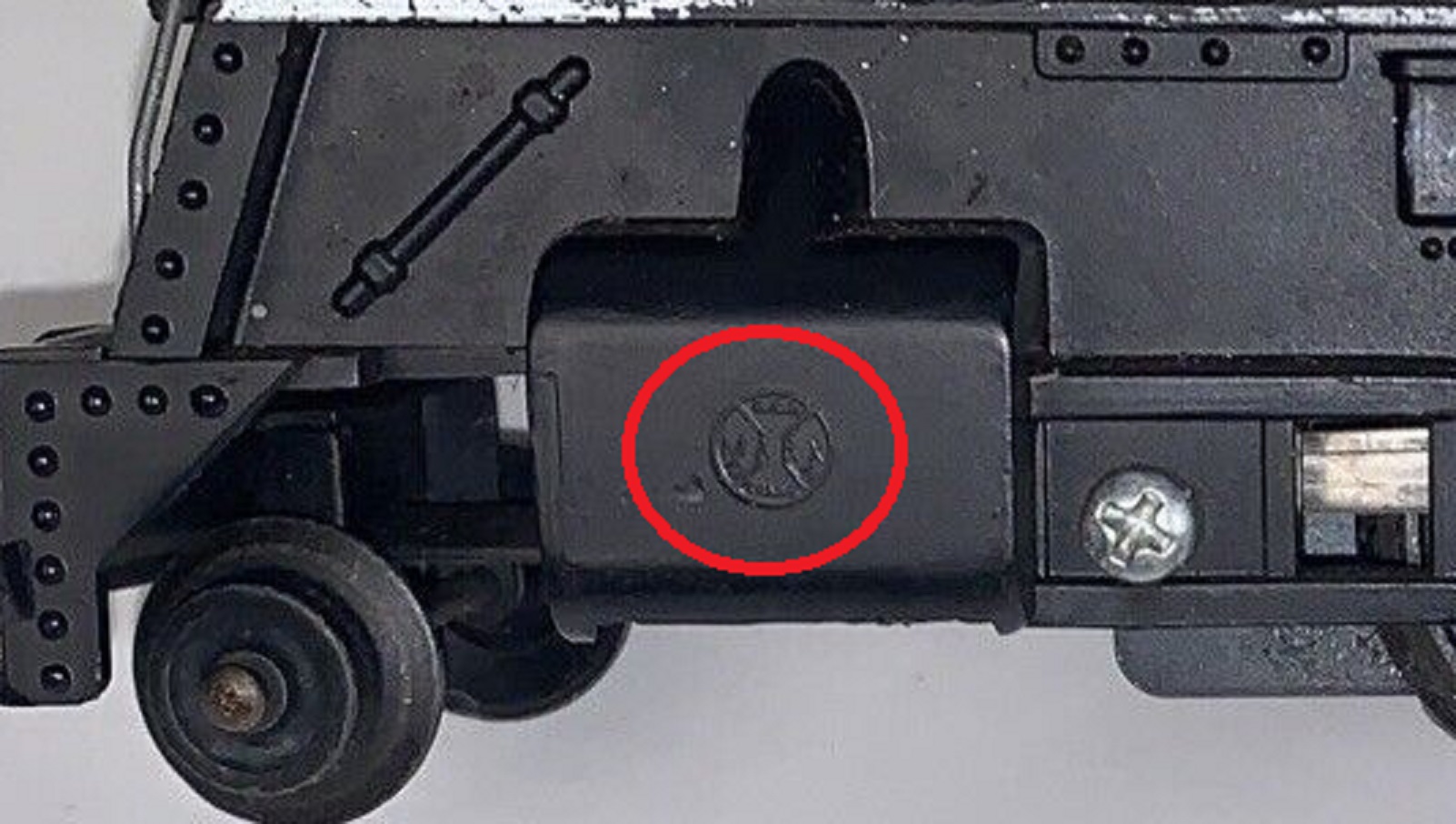

IF it is marked, it’s usually on the cylinders.

Rob… nice detail, but mine are blank… Otherwise it must be Marx (Cheap knockoff??) anyway, I do appreciate all the help… now the work begins… in between the Holiday "honey do’s)

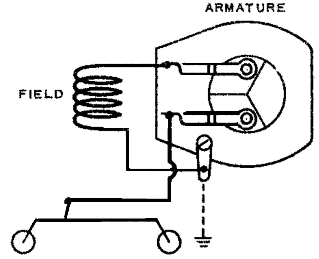

I did disconnect all wires, so the Eunit, motor and brushes should have also been isolated. [I still don’t understand how to send a photo.] The pickup wire connects to a “bar” on one side and is isolated from the frame. ( I tested for continuity to verify.) I removed all wires from that. One of the brushes was already grounded to the frame adn I reconnected the other to this bar. I reconnected one of the motor wires to this bar, and the other to the frame. That should have isolated the Eunit. I left the smoke and light disconnected and focused on simply getting the engine to move… It did not. Some sparks. It seemed to “want to move”, but something is still shorting out. Unfortunately the frame is “pressed together” and I think the Eunit’s wires are still somehow connected, even tho I cut them.

So, you need to connect the brushes in series with the motor field(one of the field windings, anyway) to get motion from the engine. Here is the simplest drawing possible to accomodate this… if it runs the wrong way, just swap the connections at the brushes.
https://i.postimg.cc/kMMdPYCW/No-E-Unit-Forward-Only.jpg
Follow the complete circuit here from the center rail pickup, to one brush, through the motor armature to the second brush, and through the field to chassis/ground.
