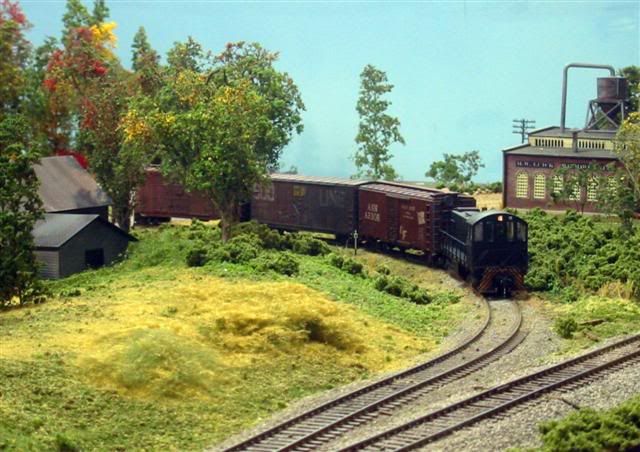

AggroJones trees are the greates but they just don’t have a Midwest feel. anybody have any information on making decidouis trees? My layout is getting close to needing a lot of them.

I did my trees using Super tree’s by scenic express. I hoped to capture Michigan in the early fall. (see picture)
For forests get polyfill pillow stuffing. Pull it out into a thin layer or large rough clumps that have been stretched until they are see through. Use spray paint to color them green. Then give them a second coat of green paint and dust with ground foam.
Another way is to wait until fall and gather dried goldenrod plants, tim to look like trees. Spray with green paint, then dust with ground foam.

The polyfill is something I had’t thought of. I will add the goldenrod to the short list of plants I am going to try for trees. So far thinking of Dill, butterfly bush, grape stems, and thistle to model Eastern Juniper.

I’ve been using that poly foam method for my back ground trees.I just cut some dead branches off trees to use for the trunks. (no painting required) I just dull coat them with some Krylon satin spray to seal them. They look great! You can make a few hundred trees for about $20.
