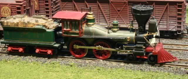

Here’s a General I reworked a number of years ago… The headlight and stack were changed, water piping from the pumps to the check valve and flags were added, and a new tender wood load made. A new motor was added, as well.
