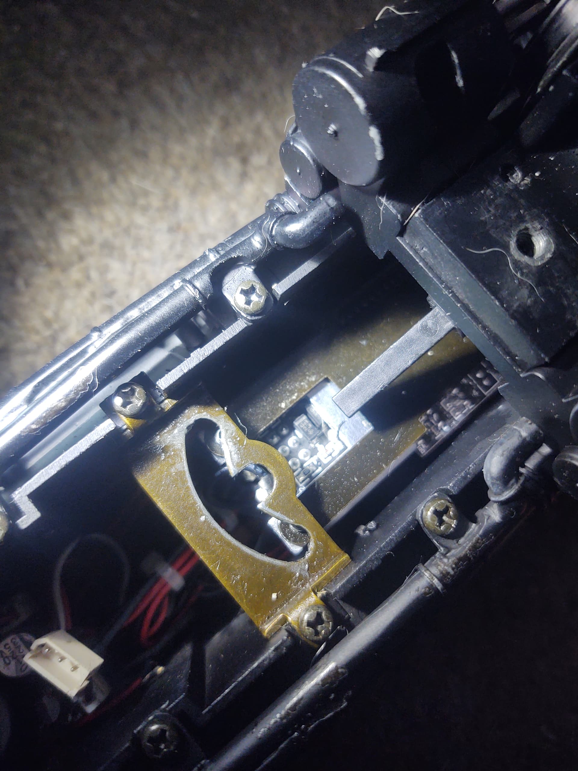

Wanted to see if there’s away to improve smoke output on Lionel’s smart smoke unit with 8 ohm heating element.did a google search and this post came up …mine you leave it at a idle to build the heat up then runing a short bit the smoke fizes out a bit…I have the ac-9 odyssey…what to that regulator board looks like..ps did in large the fan intake hole a little bit .
John is this the board your talking about to remove .
