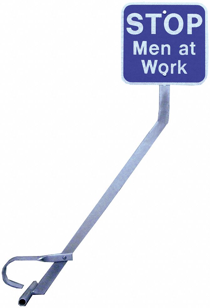

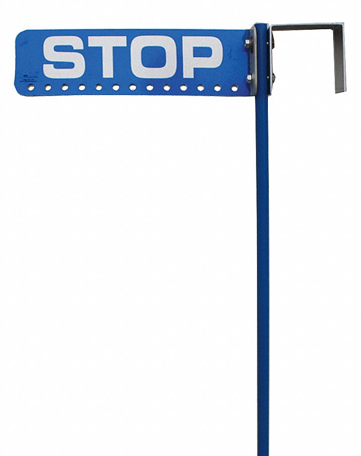

1a) I presume that originally blue flagging involved blue flags (or blue lights at night). When did blue signs like these, made of plastic or metal plates, enter common usage (I think I’ve seen them in early 1970s RR safety training films, but I’m not sure). Are these now the dominant form of blue flagging (not counting blue lights)?
1b) When did blue signs like this that you hang off of rolling stock become common (I’m sure I saw flags like that in those 1970s films) - is there a preference when you’d use these signs hanging on rolling stock vs. “free standing” blue signs mounted on posts (usually clamped to the rail)?
  1. Speaking of blue signs mounted on posts, when you have rail clamped blue signs like this, and the rolling stock needs to be protected overnight, is it preferred practice to clamp a flashing blue light to the sign, or fasten it on the rolling stock or locomotive that the sign is protecting.
  2. What equivalent sort of marking do other countries (UK, France, Germany, Russia, China, Australia, Brazil and so on) use. I know Canada uses Blue Flags, as evidenced by this RAC “Blue Flag Best Practice” document (which doesn’t really answer any of my previous questions, although it does seem Canada favors signs mounted on posts)
