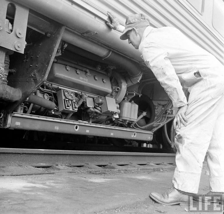

Detroit Diesel one of two on each RDC.

It gets better, of course. See that pan at the bottom? The whole engine assembly slides out on that and can be changed out in a few minutes – “works in a drawer” from an earlier era.
