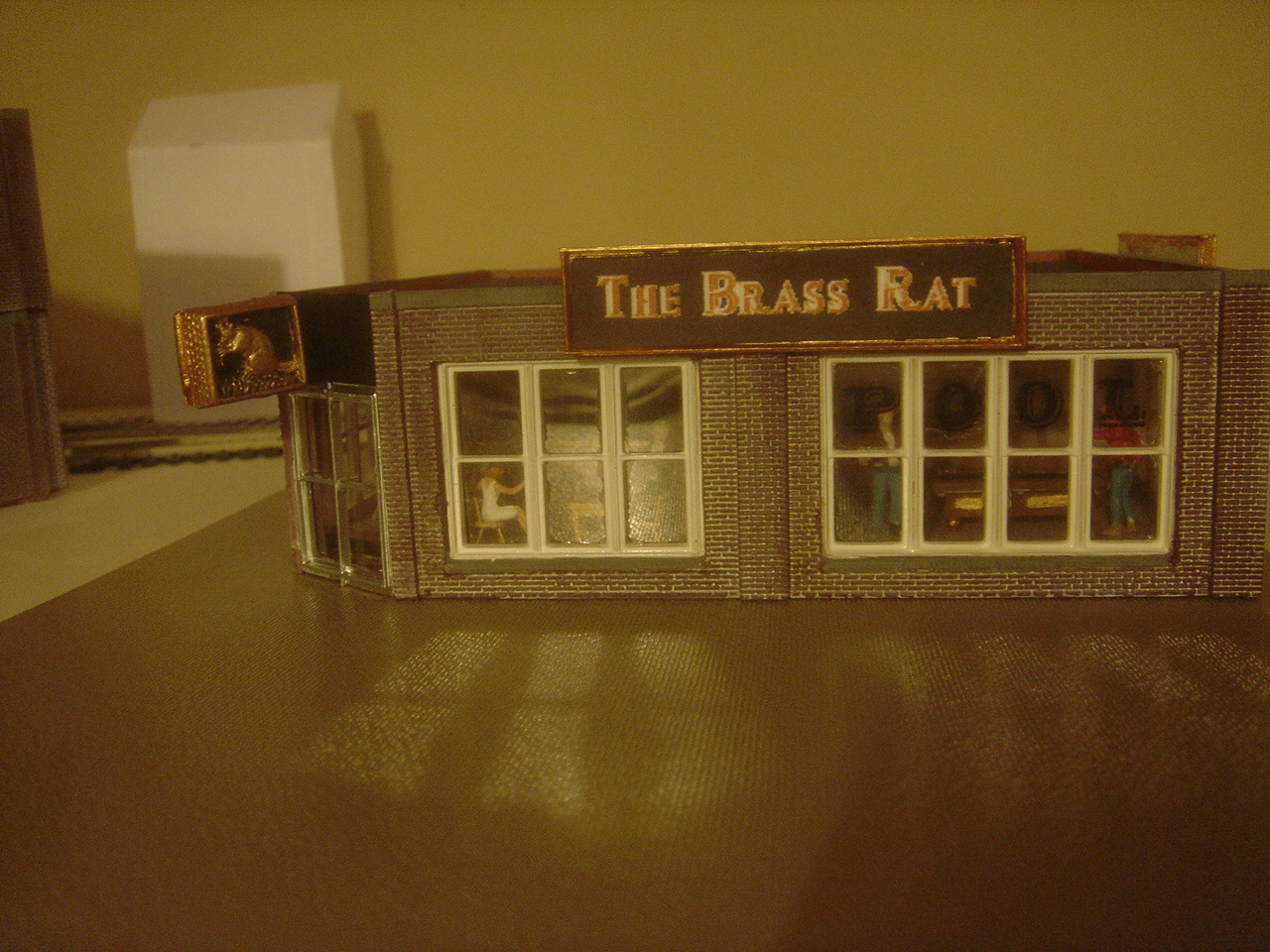

Have you thought of casting your own? I’ve made latex molds of a number of items and then cast copies in Hydrocal. As an example, the sign with the beaver on it to the left of this picture is a casting I made from my college class ring:
Woodland Scenics makes the liquid latex rubber. You paint it on and then wait for it to dry, and repeat a few times to build up some thickness. I’ve got a few of these home-made molds that I’ve used many times.
Be careful, though, of weight. If you use metal, the loaded auto racks will be extremely heavy. Hydrocal isn’t that bad, but a lightweight plastic or foam material might be better.
