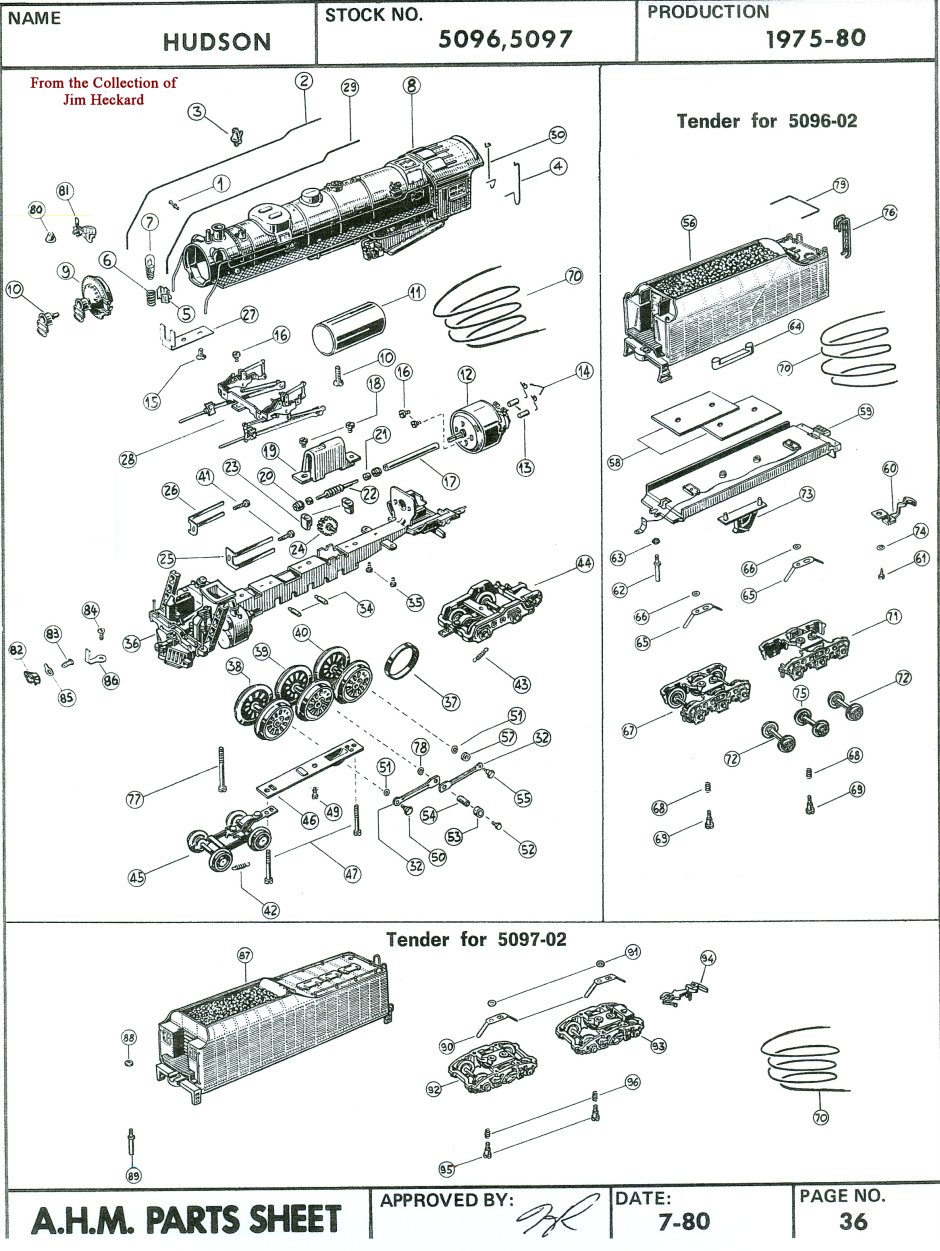

There are many explosion diagrams for these locos on the HOSEEKER website that might help. I noticed many pages for the 0-4-0 when I was looking for this one.
