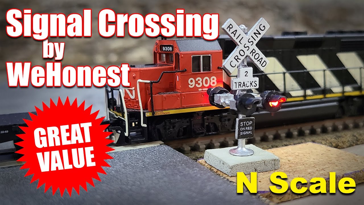

User “WeHonest” on Ebay sells all sorts of crossing light kits. I have bought several and I am very happy with them. Here is an N scale kit with sound: 1 set N scale crossing signals + automatic trigger by train sound effect & flash | eBay

I’ve used their HO signals - single head, dual head, and dwarfs - on my layout and found them to be quite reliable and realistic without breaking the bank. I haven’t tried their crossings / detectors yet, but intend to check them out in the near future.
Here’s a YouTuber’s video reviewing the N-scale crossing signals:
