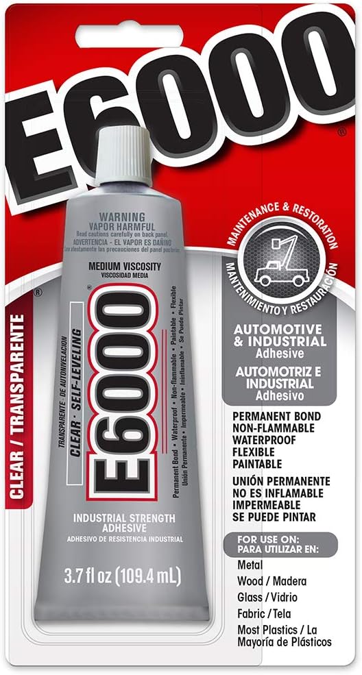

I’ve used Walthers Goo in the past but it will have a tendency to react with the plastic which is no good. The recent E6000 adhesive is pretty good at sticking weights without damaging the plastic:
Otherwise I use double-sided foam tape.

I’ve used E6000 too. It’s pretty strong stuff!

Two of the suggested adhesives (E-6000 and Beacon 527) are available at the local Walmart. Ed also suggested double sided tape, a duh moment for me, given that I have ready supply the train room. I’ll give the tape first shot and if that doesn’t work, I’ll buy one of the adhesives.
