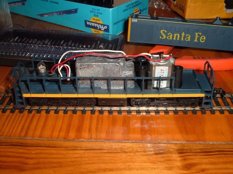

Forum member “SteamFreak” did this exact conversion a few years ago. I just checked, and he still has the pictures in his Photobucket account. As far as conversions go, this looks like an easier job than many others I’ve seen and done. If you ask him, I’m sure he’ll give you a walk-through.[:D]
Oh yeah, the motor used is a type FK-130SH by Mabuchi. They run nearly as well as Mashimas. You should be able to get them from Bowser (part #79. Not on their retail site, but I’m sure you can call or e-mail them).

Darth , you are the greatest for helping out on this . That Alco 1000 has the same drive as mine does , and I wondered if anyone had done one up before . Thanks for all of this info , and Ill be sure to save it . Now all I need to do now is get a motor , and a worm gear . Im sure Ill find one somewhere .
Update : Since my last post about this AHM repowering issue , my complications have pretty much been resolved . I managed to take the motor apart , cleaned it , filed down the magnets to the proper spacing , added another spacer ring , found another worm gear ( friend gave me an entire powered truck assembly ) , then I re-assembled the motor . It runs well , running on DCC , starts at 10 scale mph , lower amperage draw , pulls cars very well . I will however at some point in time down the road install a can motor . Thank you to all who did and could help in any way .
