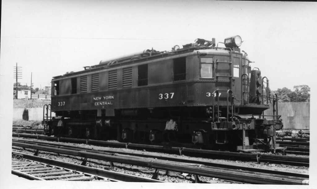

Here’s a photo of an R-2 I found depicting the ‘fatter’ whistle just behind the headlight:
New York Central Electric locomotive #337 001 by John W. Barriger III National Railroad Library, on Flickr

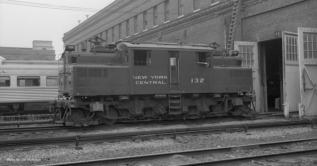

This view of an S motor shows the ‘skinny’ whistle with the pie tin at the bottom on the #2 end with the short, fat whisthe on the #1 end.
NYC S-2 132 by Joe McMillan, on Flickr
