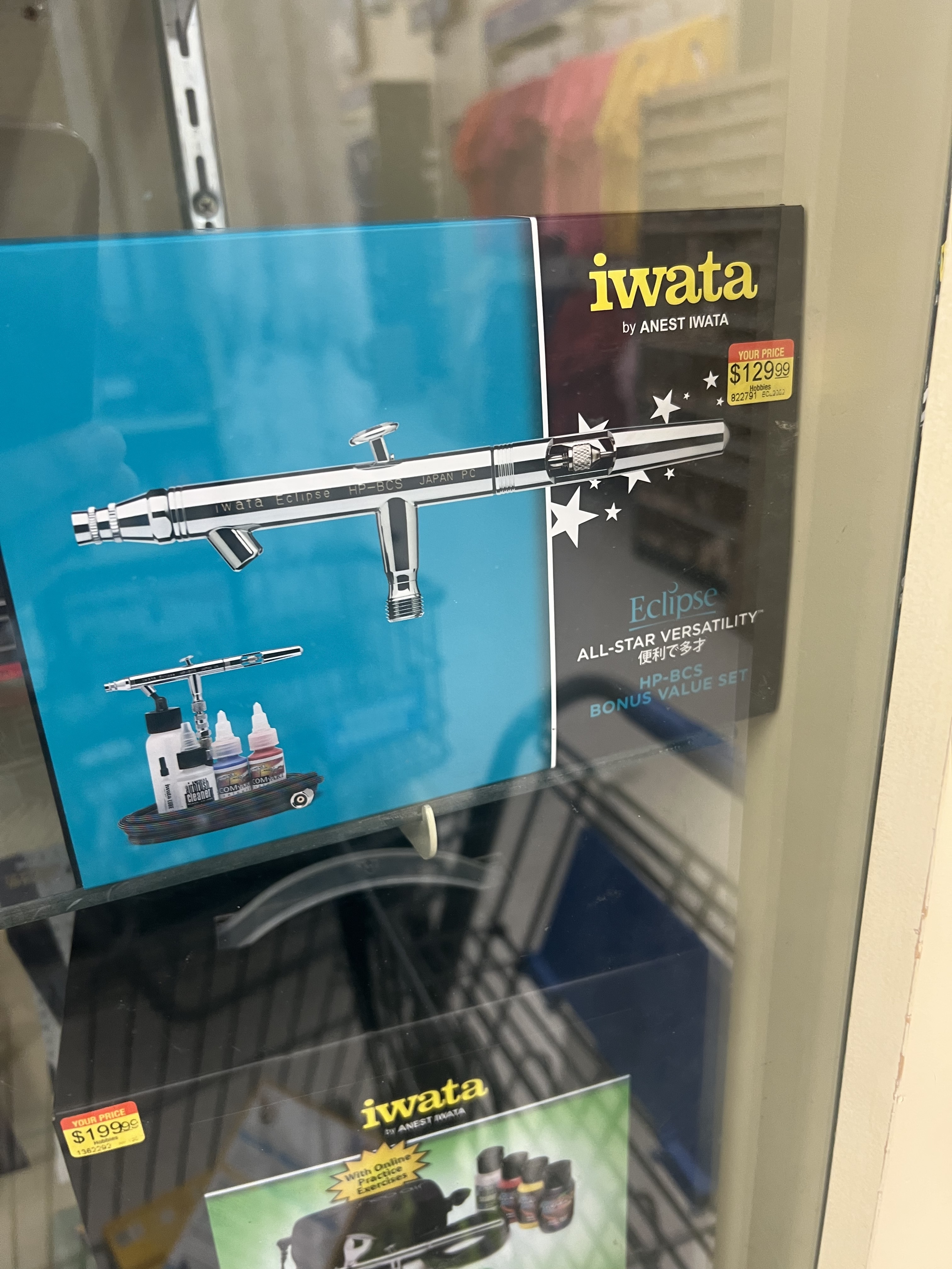

I’ve been researching airbrushes as well. I’m told the Blackwidow by Spectrum is an upper middle class brush that’s more than enough for my needs. My local Harbor Freight store has them for $80. Also was told you definitely want an air compressor with a storage tank and moisture separator. Again my local Harbor Freight has one for around $100. Hobby Lobby also carries an Iwata brush that I’d call being in the lower upper class brushes. It’s $130. The air compressor Hobby Lobby carries is not recommended bc it is on demand and can cause the brush to spit. Finally it was recommended to have a gravity feed as opposed to a suction brush.
Let me know if the pics didn’t post and I’ll try again.
John
