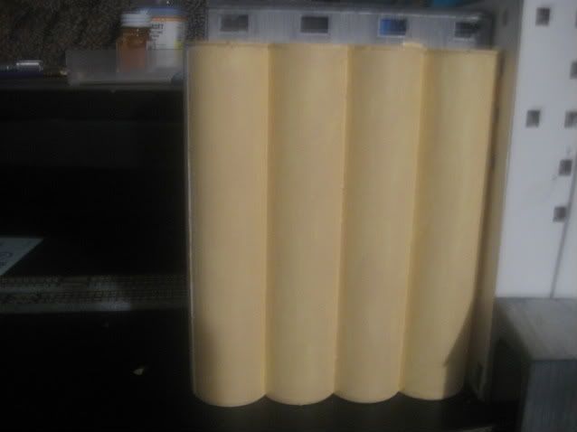

I hand paint my buildings and use a airbrush to paint locomotives and cars.
Here’s a on going project I am hand painting using Polly S CSX Tan…
