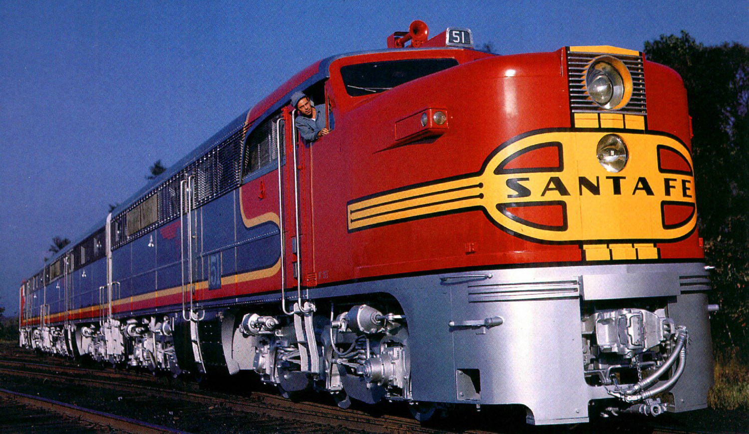

https://www.american-rails.com/images/ATSFPAPUB1.jpg
Thank You.
In my dim and distant high school days, I remember shooting what may be the last pictures of ATSF 51 and 51A in the scrap line at Pielet Bros. in April of 1969.
