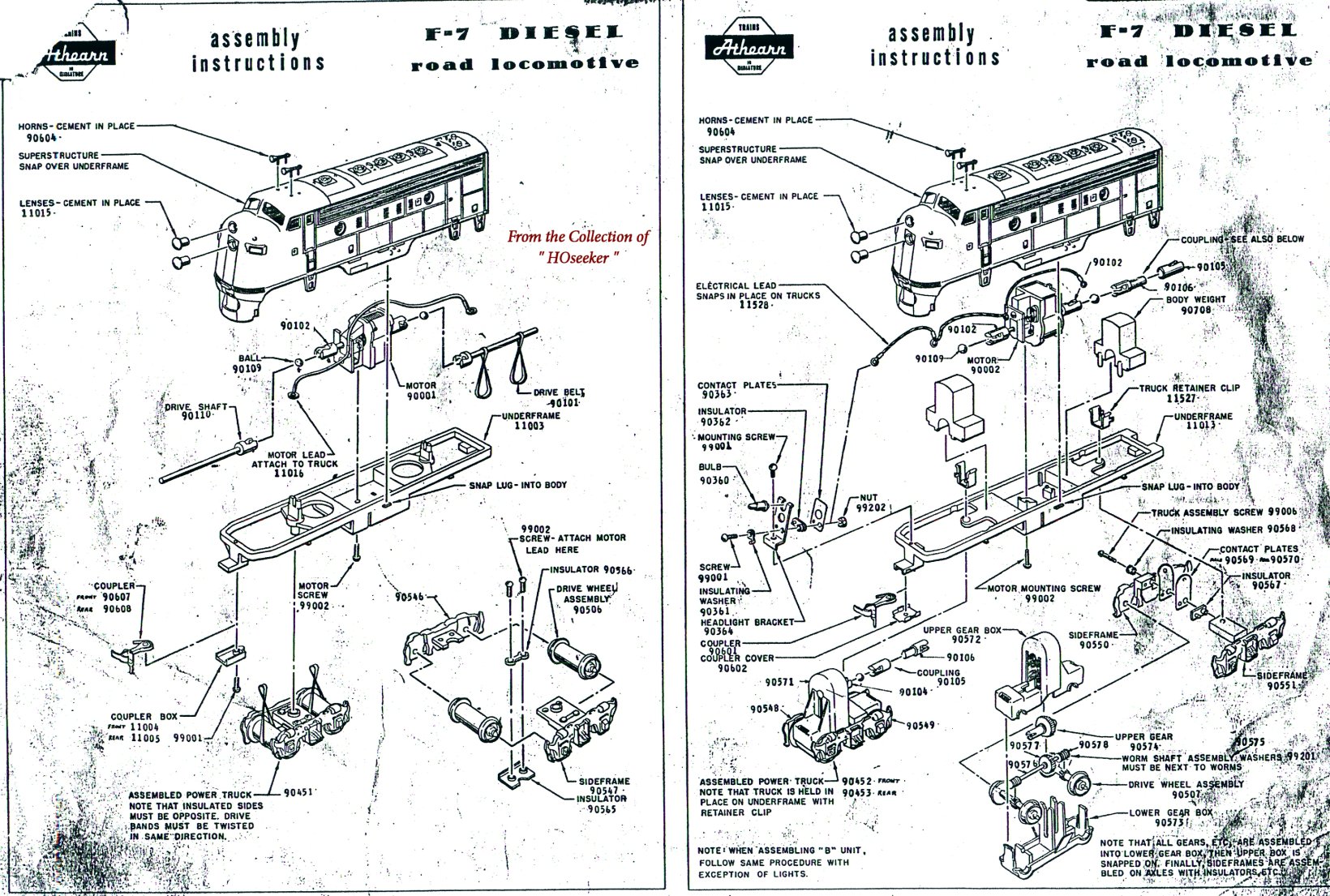

The rubber bands were applied in a figure 8, with one on each end of the shaft as I recall. You can get assorted sizes of rubber bands at office depot or ebay and by trial and error you will find what is best. I doubt actual replacements are available of course.
I still have the rubber band drive F7 I got for my birthday in 1958. It runs quite well but low speed is not great. Anyway just try to find some bands of similar size. To get the ones on closest to the motor pull the shaft out of the rubber coupling. To get them on the axle take apart the truck. It is easy to do as there are small screws holding it together. You may have to try different bands to get ones ro give the correct tension.

Remember that the shafts projecting from the motor rotate in ‘opposite directions’ relative to the wheelsets, so be careful that you twist them the ‘right’ way to make all the wheels turn in the same direction…
This image from the HOSeeker website should help you out with orientation:

To install the rubber bands, take out the two screws holding the truck together, place a band onto each axle, then reassemble the truck. Stretch the bands over the motor shaft, making sure they’re all in the same direction, and off it’ll go!
