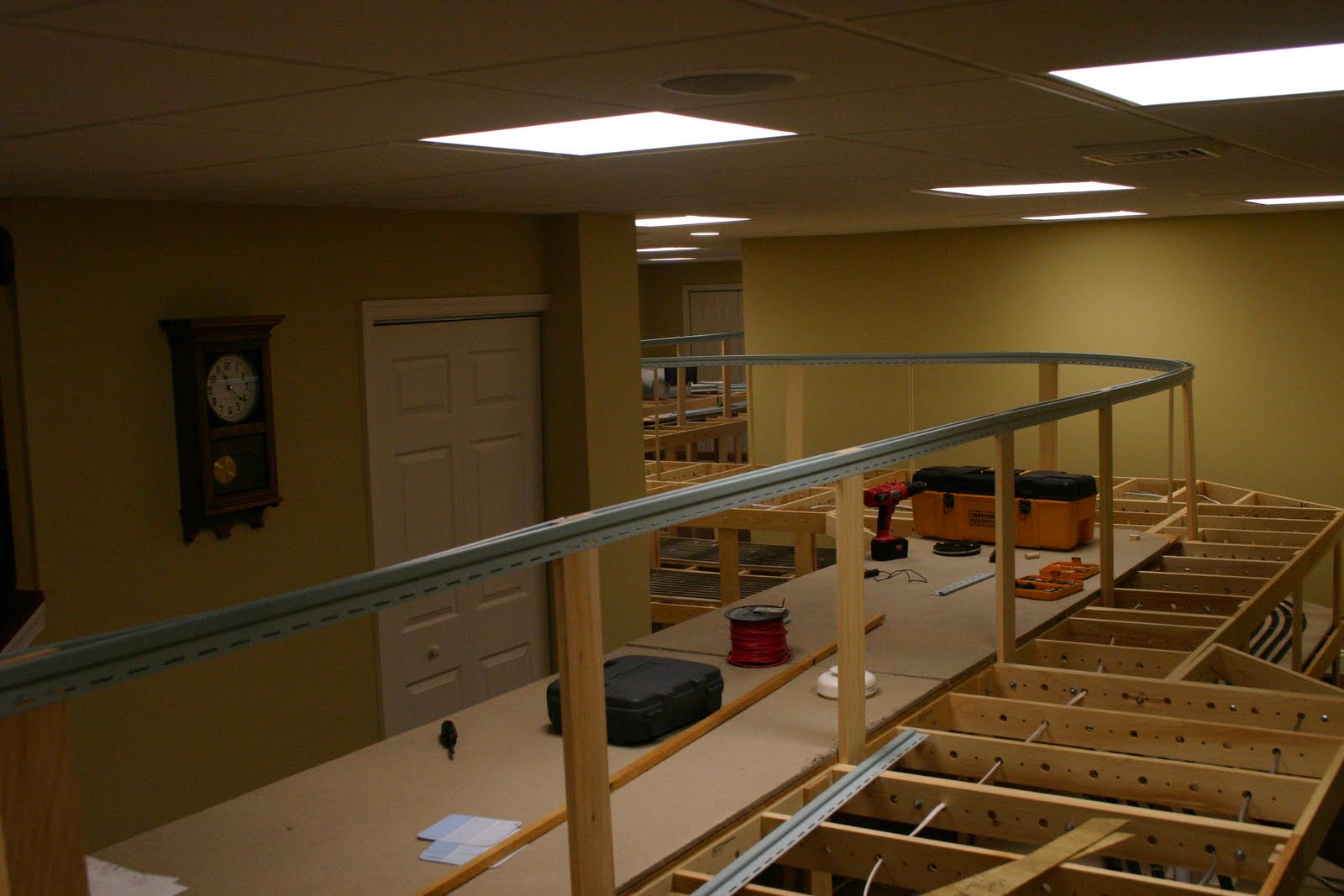

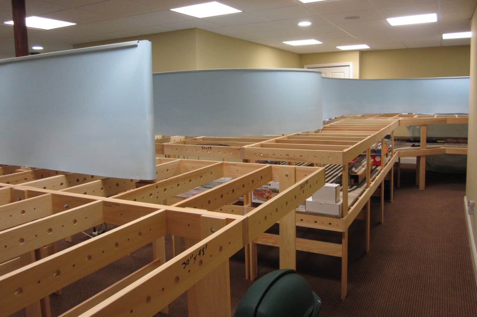

Here’s a couple of pics of my install a few years back.
After some scenery and paint…
I didn’t take it all the way to the top for several reasons generally irrelevant other than to using the stuff in my basement, but you can easily do that.
Lots more pics of my backdrop going up on the Cascade extension here:
http://cs.trains.com/mrr/f/88/t/219241.aspx?page=1
I have used 24" x 50’ aluminum coil stock for many years with no issues. It’s top mounted in a plastic strip made specifically for aluminum sheet metal used in roofing applications. You will also need a crimper and a good metal cutter. Check with your local dealer or large roofing wholesale supply… Reynolds or Noranda are two. The sheet stock can be painted with any latex paint. I use white at the bottom horizon and blend darker blues toward the top. REL
I’ve used this material very successfully for my curved backdrop on the layout. I used a j-channel to support it at the top, making installation extremely fast and easy. Once installed, we painted it blue with a subtle lightening at the horizon.Backdrop support
