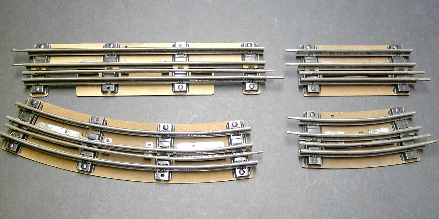

I can add a little information. The tender has a u shaped pickup on the bottom.
Picture 3 of 7
This is not a Hiawatha tender but a similar one.
The tender was designed to run on 4 rail track (40" diameter). One side of the pick up rides on the 4th rail. The rail is energized by a button connected to the power source. I’ll have to see what other information I can find for you.
This is what the track looks like.
