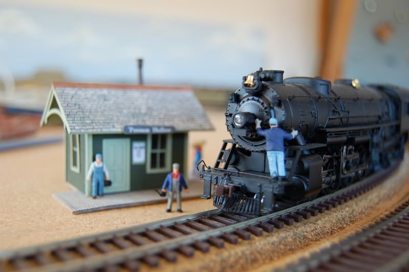

potsie, I too like the ease of assembly that AMB provides. I did the crossroads church for my first attempt. Then I kitbashed the Branchline Station with new rail model ultra shingles. I used bragdon chalks to make the metal ridge cap. My husband did the schedule for the signboard & station name on the computer.
Sorry about the blurriness it was one of my first photo attempts with a new camera.
The 2-story farmhouse will be my next project.
I thought that they were very simple for my first try at structures.
