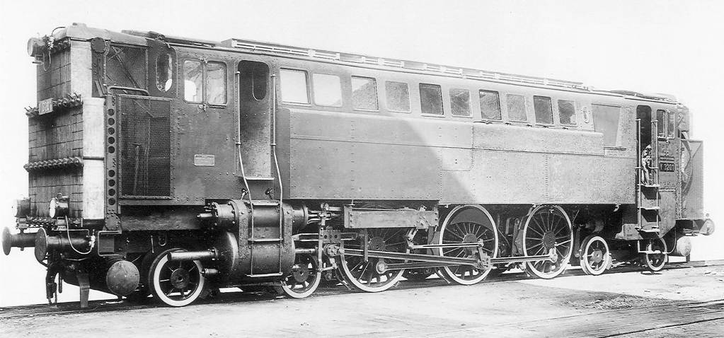

An attempt to marry the characteristics of steam propulsion with the fuel economy of the diesel engine:
Succeeding mainly in marrying the maintenance intensiveness of the steam locomotive with the higher capital cost and complexity of the diesel engine. For thermodynamic benefits largely accruing only in steady-state operation, and (at the time) requiring some fairly fiddly adjustments to work. These can be achieved in marine practice (cf. the Sharp ‘turborecompression’ arrangement) or stationary arrangements (Anderson recompression, as tried in the Holcroft-Anderson experimental locomotive on the UK Southern) but absent the kind of operating conditions that, for example, made GPCS workable on the Rio Turbio 2-10-2s for a while the results won’t be as good for general railroad service.
The gains from recuperating diesel-exhaust heat in some kind of ‘boiler’ appear to me to have been terribly overestimated. You should read [Douglas Self’s description of the Still system and then follow the two blue links at the bottom to his coverage of the Kitson-Still and Schneider-Still locomotives and the ‘teploparovoz’ 8000.
The correct use of diesel exhaust would have been in a Franco-Crosti style economizer, but it is still (no pun intended) questionable that meaningful heat recovery for the required capital and maintenance could have been obtained.

Anyway you look at it that Kitson-Still hybrid was just too damn ugly to live! Yuck!
A Stanier Pacific it ain’t!
Well I dunno…kind of has an Alco- Westinghouse-Pennsy thing going on, with a little bit of Soviet T-34 thrown in. …except that middle part with the windows, some streetcar/trolley manufacturer.
Handrails/ steps draping over the cylinders…oh yeah that’s safe and acceptable isn’t it?
Obviously designed by committee.
