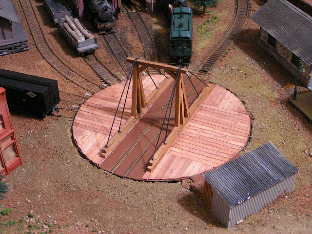

Beneath this pit beats the heart of an Atlas:
I described building this in an earlier thread:
http://www.trains.com/TRC/CS/forums/1162790/ShowPost.aspx
Others have built a “gallows bridge” on top of an Atlas deck. It’s another option to hide the basic Atlas deck a bit. The venerable Atlas design still seems like the best short-engine turntable solution where you don’t have the space for a larger model. For a fold-down like you’re proposing, its surface-mount configuration and low profile might be exactly the answer. The turntable is inexpensive, and you can add a motor if you’d like. It has built-in 15 degree indexing and it handles track polarity automatically, too.
…and reliabilty. I have to complete the sides and the motor shed.
