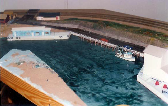

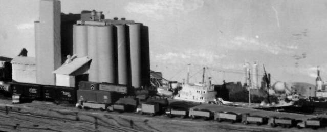

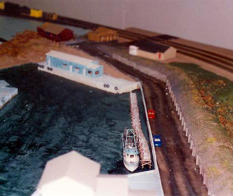

I used a Heller ocean-going trawler to “suggest” a ship near the backdrop in a 4x1’ scene that was part of a 2x4’ layout.
I used the hull of a wrong-scale 1/200 tuna seiner with an HO superstructure to create an HO small shrimpboat.
This is probably not your era, but I thought I’d throw this up as an example. BILL
