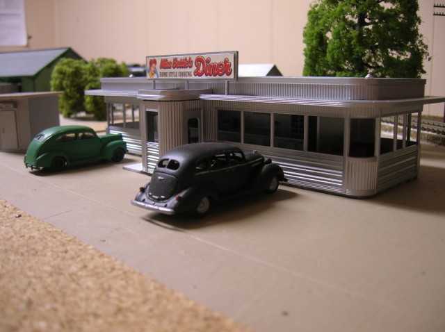

I have the Walthers Miss Bettie’s Diner. While the interior is detailed, I found out a couple of months ago that HO-scale people do NOT fit in the booths because the spacing is way too cramped. If you plan on putting people in the seats, you’ll need to spread the spacing of the tables out.
I have it mostly finished, although there still is some important detailing left to complete. I’ll try and post a couple of pictures tonight after I get home.
Here’s what Walther’s Miss Bettie’s Diner looks like:
It is nice kit, although the booth spacing is too cramped inside. The plan is to eliminate 2 or 3 booths then space the remaining ones out a bit so that there’s more room. I’ll also add a few patrons - most of them being RR employees.
The linoleum flooring and the wood floor planking behind the counter I added myself. I’ll also be adding interior lighting and probably a small neon “DINER” sign out front. The grill area will definitely need to be “greased up” a bit. Also, since the roof is flat, I’ll add some stone on top.
Man, Tom, that looks nice. Great job. I wonder if a structure like that will fit in my modern era set in the midwest. Even if doesn’t I think I could make fit in.
Will,
Absolutely! There’s still a number of these diners around the midwest, as well as the rest of the country. If you do a Google Image search and type in “stainless steel diners”, you can find a slew of examples. And you can keep it “retro” as little or as much as you want. I’m trying to keep mine in the 40s.
