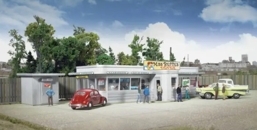

Thanks. I was thinking about using that particular primer for the interior of a diner. Rather than masking I was just going to paint the whole thing and then do the exterior in the black gloss and shiny metal over the primer. I’m not worried about losing details.
If it’s not advisable I will do them separately.

Do you remember how coverage was? I am going to paint the exterior of Walthers Miss Bettie’s Diner and I need to know whether I can do it with one bottle of paint or if I will need two.

I figure the diner is a little less than two cars. Is one bottle enough?
I think it should be. No one else seems to be willing to come out and say so, though…
And I get that. I doubt anyone else on here has done that structure with the paint that I will use. Given that you mist it on I suspect that it will go a long way.
