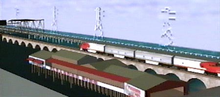

I have started a layout with an island seaport theme which will have some ocean background. The island seaport is accessed by a mile-and-a-half long stone arch rail causeway, represented by the top portion of 8 Atlas viaduct sets. Bay background to be painted so horizon level is about even with rail-top level. A highway bridge behind (from layout viewer’s POV) the rail causeway will help obscure the transition from flat modeled water surface to 2-D backdrop.
Computer nrendering of planning finished scene–
causeway scene halfway done Jan08. I propper up a paper sky-and-clouds background to pose a temporary scene.

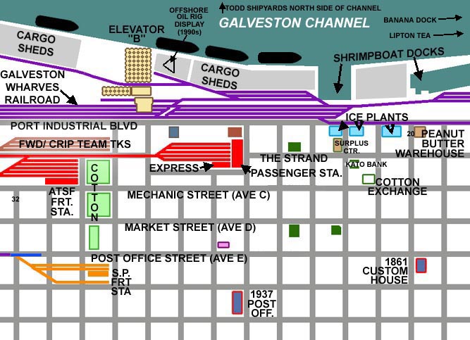

My layout will have cargo sheds at the back of the layout (with staging tracks hidden inside!) and the tops of ships visible over roof of the sheds, painted on BG. Trackplan of this part of layout…
All I have so far is roadbed and track so nothing to show of actual layout. Here is a computer persepctive rendering of planned scene…

The 3/4 high-angle oblique view of the causeway scene, and the view across the passenger station platforms towards the shipside cargo sheds are Amiga Video Toaster renderings of 3-D computer models built in Lightwave 3D back about 2001. I have been dreaming and planning towards this layout almost a decade and was about to start assembling sections in my spare room over the last Christmas holiday before a financial/housing situation landed an in-law camping in the room.
