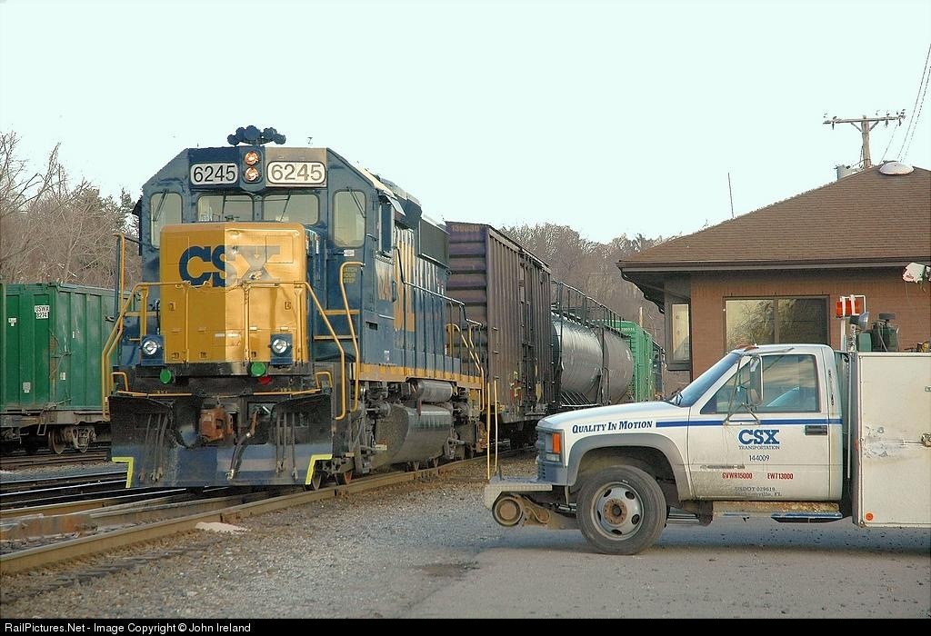

Secondly, many diesels are now fitted with ‘plow pilots’ as standard equipment all the time now anyway. EDIT - Here’s an example of a CSX GP40-2 from March 2006 at its North Croton Yard in New York - note that the lower corners of the plow have been cut away to clear the electrified outer 3rd rail on the Hudson line and into New York City:
That was rare back in steam locomotive days, because the sides/ wings of the plows hindered access to the cylinders and valves - always high-maintenance items. Also, until recent decades, many locomotives had ‘footboards’ on the ends for brakemen to ride on during switching operations, which back then were more useful the rest of the year than a plow would be - but since I believe those have now been outlawed or fallen into disfavor, there’s no longer a supervening reason not to install a plow. Plus, the plow pilots are good not only for snow, but deflecting
