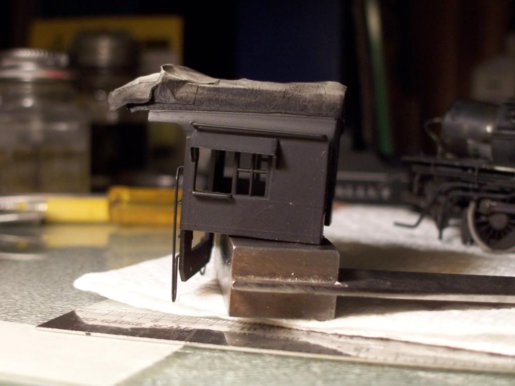

If you can find the correct style and size as dry transfers, any colour can be used, although it involves a little more work. Simply paint the background the colour which you wish the lettering to be. Allow the paint to fully cure, then apply the lettering as you normally would but do not burnish the letters once they’re in place. Next, paint the area using whatever colour you wish the background to be. As soon as it’s dry to the touch, use bits of regular masking tape to dab at the applied dry transfers - they should lift-off fairly easily, either as one piece or in bits. The thin lines will be hardest to remove. Particularly stubborn areas sometimes require the judicious use of the tip of a #11 blade. Use a brush to touch-up the paint as required.
EDIT: While we no longer need to click on the area below a photo to get an enlargement, clicking on each photo will yield an enlarged version. For some photos, clicking on the enlargement will give an even larger image. [swg]
Here’s a loco cab lettered in this manner:
…in progress:
