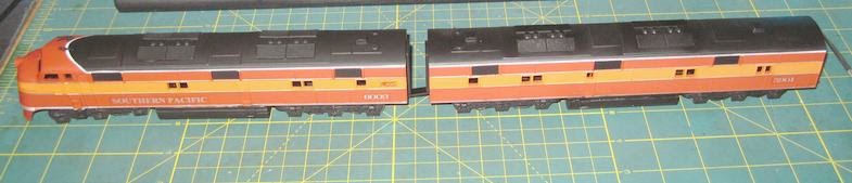

I have 19 Athearn BB locomotive drives and none are what I would call noisy. Proper lube takes care of noise for me. I have remotored all 19 with can motors. Two came with A-Line conversions and both are very quite running.
My E-7 power houses are Athearn SD40-2 Frame and trucks with Mabuchi FK280SA motors and Bowser Cary E7 metal bodies. They weigh in at a bit over 2 pounds each and have over 9 ounces of drawbar. Running without sound about the only noise I hear is wheel click on the track.
