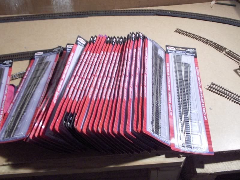

Why the question Don? Do you still not believe me? I remember this discussion from few months back and I thought that you had left it behind you. So ones more, I do have c83 Atlas track and turnout/and some Roco and one Peco) and it’s the Atlas ones that I’m building my layout with. If you do not believe me and just wan’t to argue do is with someone else. I’m done arguing whether I have something or not. Move one.

Here is a pic so that you one and for all quit bugging me about this. I’m fed up with your insinuations:
Now can we agree that those are indeed Atlas track and turnouts?
Magnus
