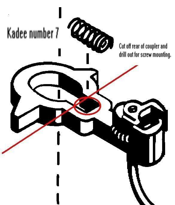

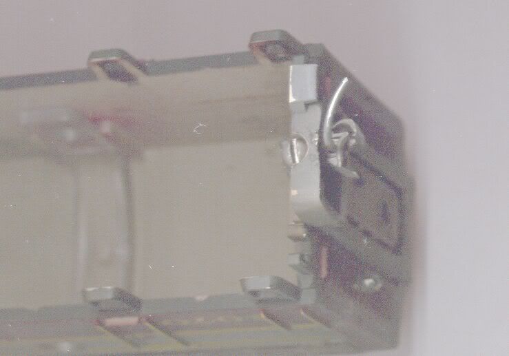

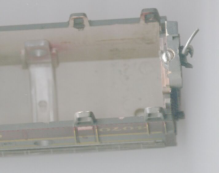

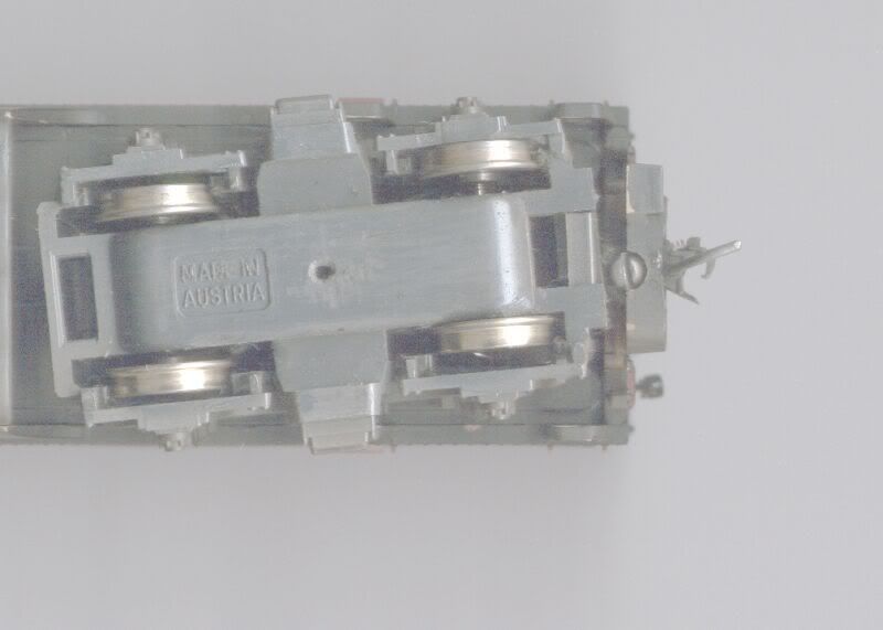

Here is how I close couple my old FP7’s…
It doesn’t self center, but it will “close couple”:
A big thanks to Msowsun for posting his method of close coupling the Atlas FP7’s. I’ll put that on my to-do list for my two FP7’s.
