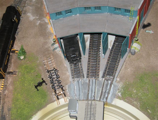

Hello I have one but it has 6 stalls. My dad made it for his layout and then he thought it was to big so he gave it to me. I cut the hole floor out and made one form skinny sticks. I used all flex track . But I did move it back form the TT so everything would line up. I have a Walthers 90’ TT I have a piece of roadbed around the edge for height . Here are some pics.
hope this helps Frank
Thanks for all the pictures guys! That REALLY helps a lot!
Mr.B-Love the inside brick work. It will be right up front on my layout so detail is important.
0-6-0-That floor looks great. I think I’ll probably not use the stock floor and make my own concrete pad. I was wondering how it would look that close to the pit. Looks like you have about 2-2.5" of apron there.
