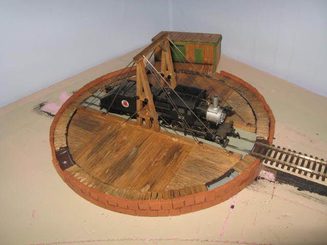

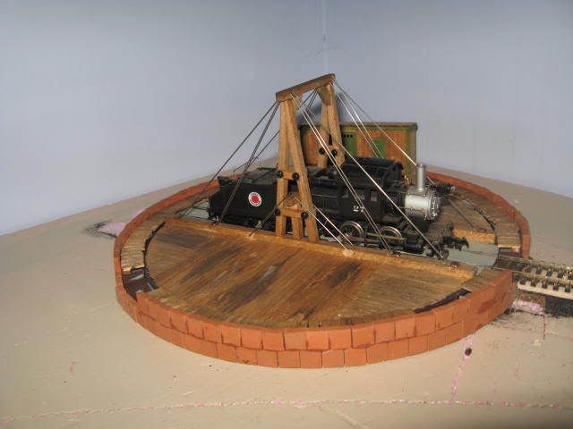

I recently completed my Atlas TT kitbash. It will be used for turning engines only in a kind of backwoods setting. I used balsa for the planking, blocks from A.C.Moore, stain and india ink/alcohol weathering. Based on the famous gallows TT at Laws CA, I consider it “stand off” scale only but I’m pleased with the result. Permanent mounting on the layout, filling in the mounting hole spaces, plus appropriate scenery is my next task. This project was really fun!
The prototype:
My model:
