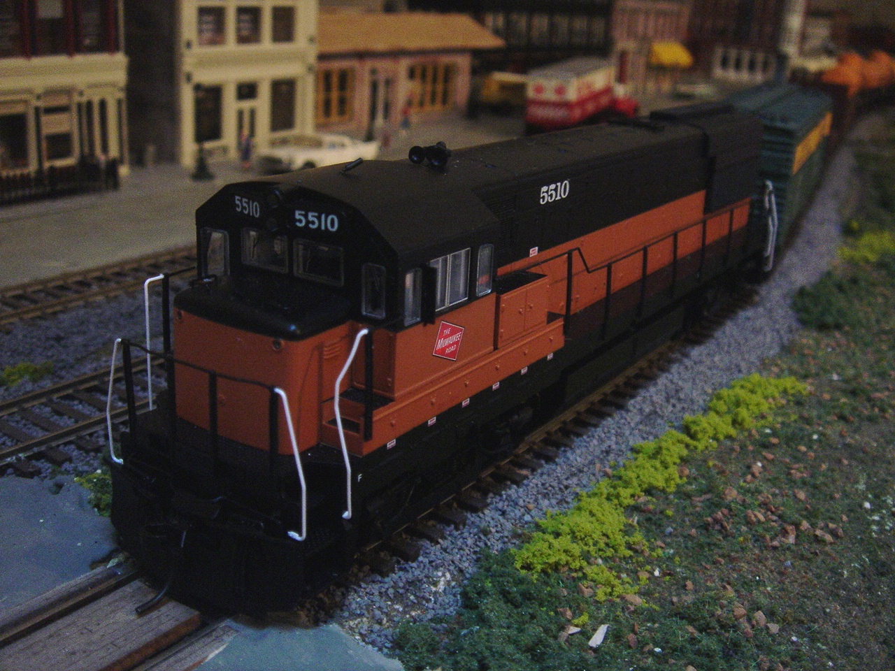

Here is my Walthers-Proto U28B:
Since you mentioned Milwaukee, I thought you’d like a picture.
