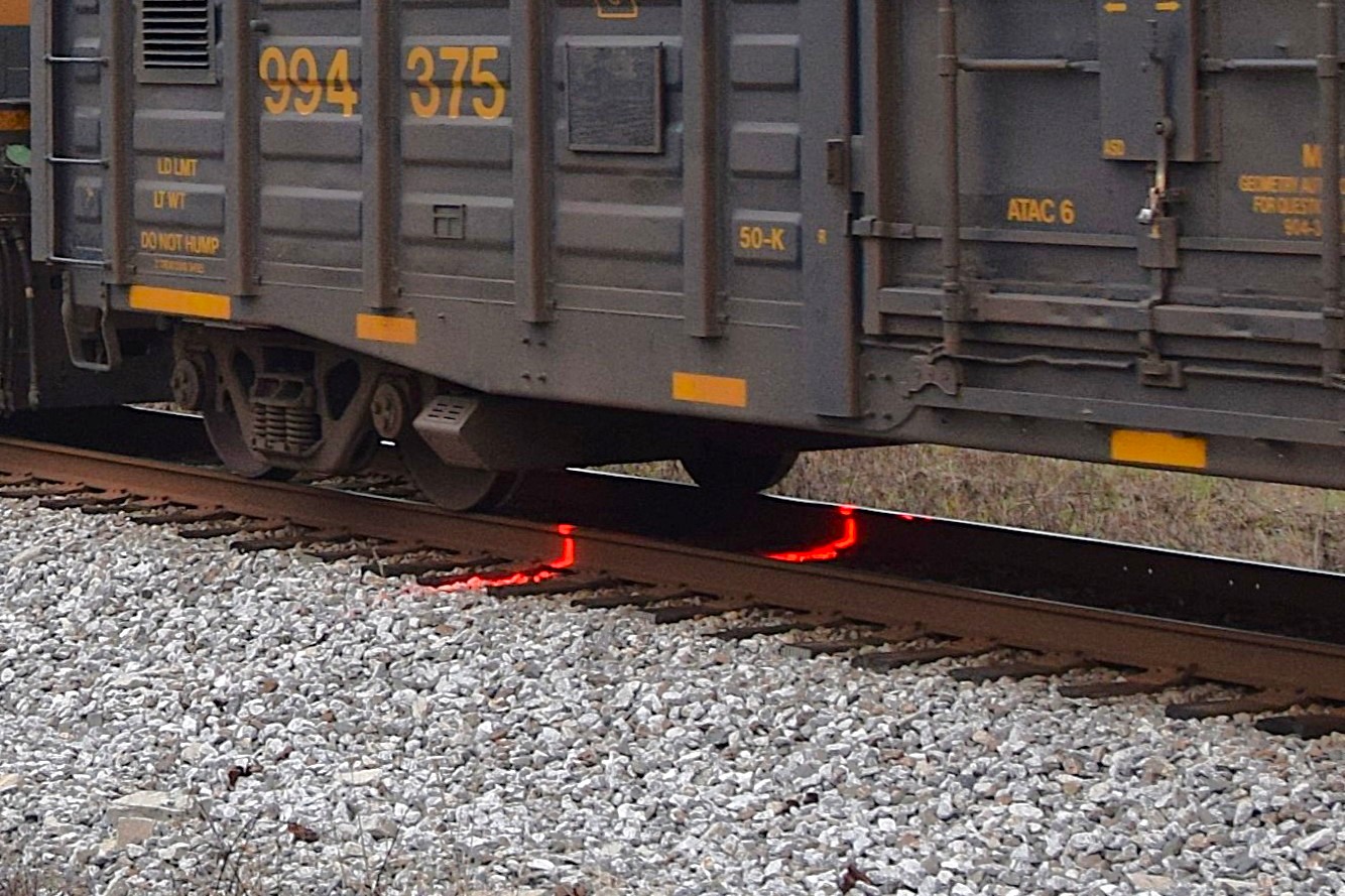

CSX rail inspection boxcar runs over most principal routes, usually on intermodal trains behind the motive power. Seen here southbound approaching Waycross, GA on 12/4/25. High intensity light can spot minute rail defects before they become a hazard.

I see these on the CSX/ ex NYC Water Level Route with some regularity, but never noticed the red scanning light on the rail. Does anyone know if the train has to run at a slower speed for the geometry car to operate, or can they still do their work at intermodal speeds (up to 79 MPH)?
Track Speed! The send data back to MofW HQ in Jacksonville and a computer application will identify parameters that fall outside defined parameters and they local Roadmaster will be notified ot the bad reports.

I see the ‘track geometry’ laser-equipped boxcars on occasion on the ex-IC freight bypass in Memphis, usually as first car behind the power. They run at track speed even at night, and the red ‘line’ is very visible then.
