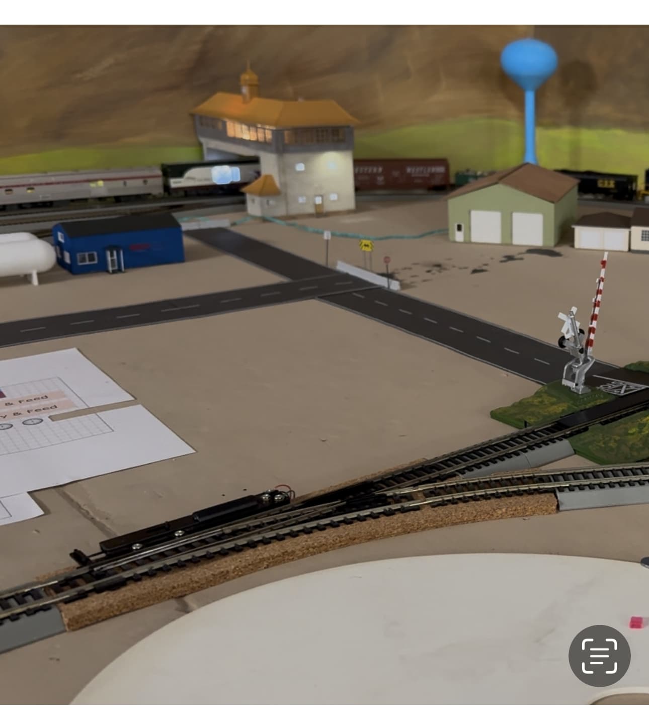

I have some experience with Cork bed (Midwest) and It’s done me good. With that you also don’t have to worry as much if a track or turnout dies, as you don’t have to rip up all the ballast and scenery under or by the roadbed just enough to get the track on top out, and that’s pretty rare. In my opinion, Regular track also conducts power better.
Here is a picture of the Atlas Turnout (replaced the Bachmann one) using cork material as the bed.
This turnout works incredibly well. I have even successfully backed up my freight cars with no derailments.
