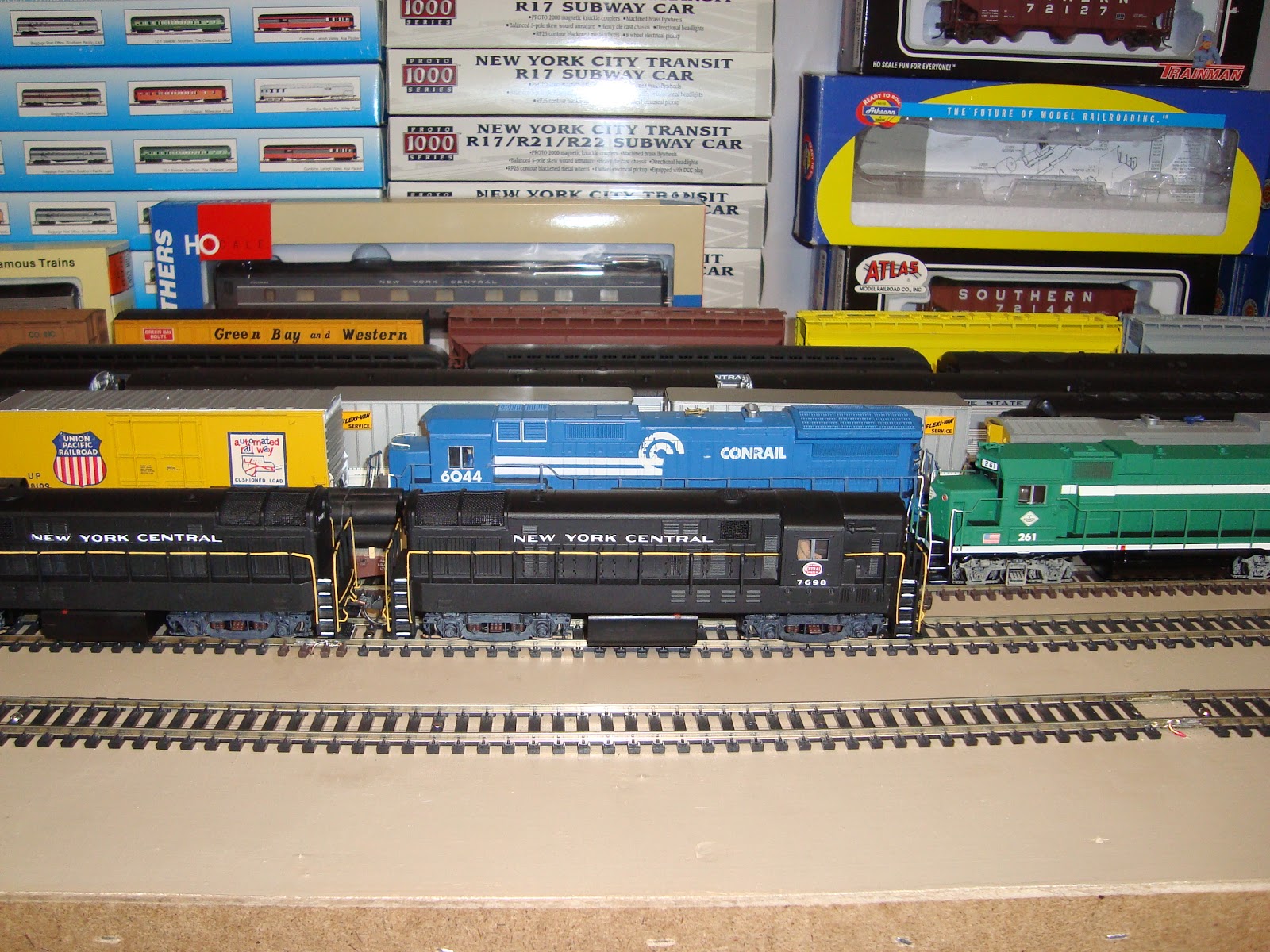

I bought two of the Spectrum H16-44s myself and painted them for the New York Central. Here they are in my staging yard. After a good cleaning and tuning they run fine and are some of my favorite engines.
John
