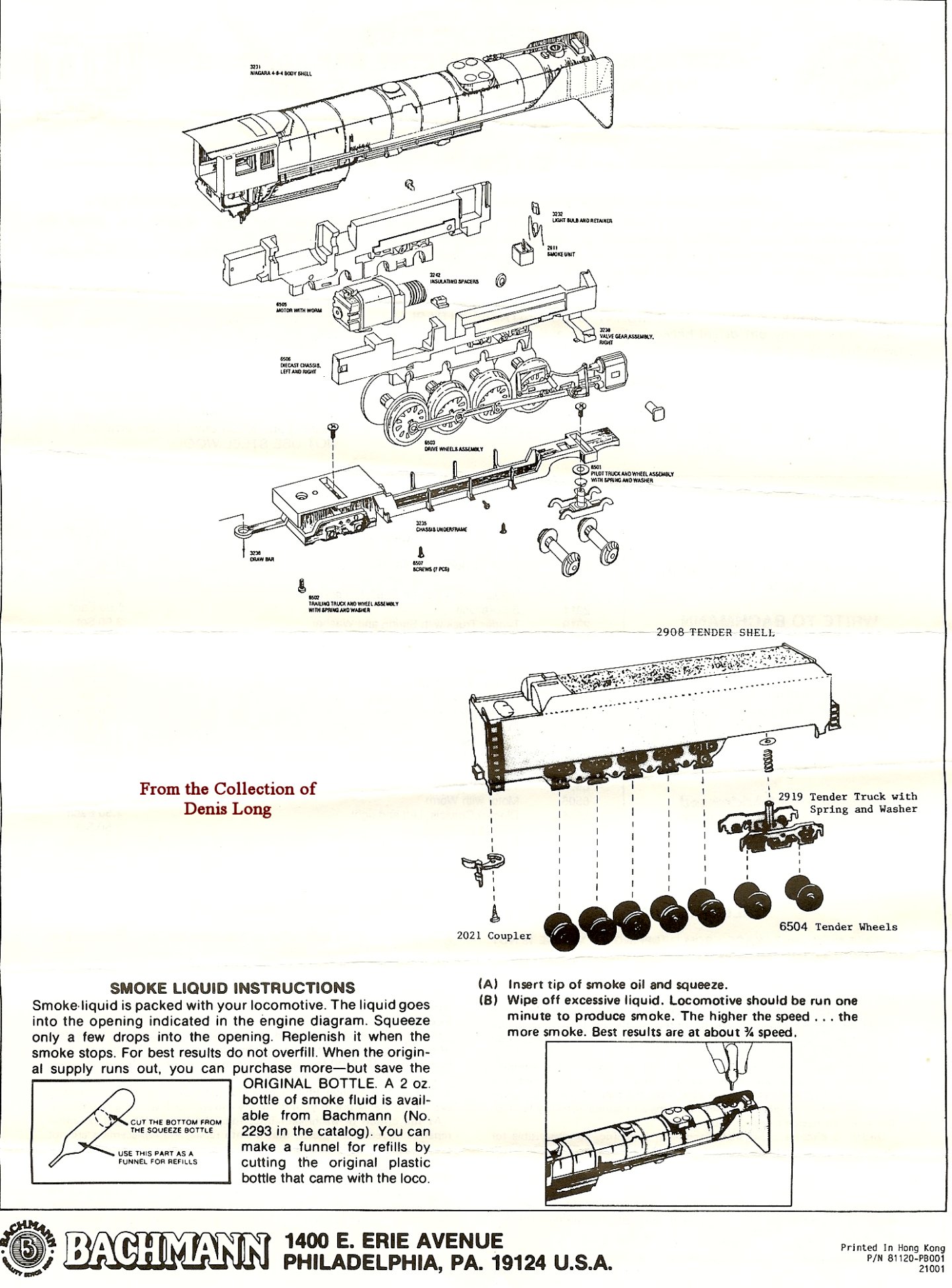

Not sure if this helps…
https://hoseeker.net/assemblyexplosionbachmann/bachmann484niagarapg1.jpg
https://hoseeker.net/assemblyexplosionbachmann/bachmann484niagarapg2.jpg
I have a 2-10-4 of the same series, and it runs very smoothly. It is NOT the same tooling as the previous generations. Mine also came with the openings for the speaker, but without sound. There is no smoke option. I believe the mechanism is the same as the Spectrums of the time, but without the details and sound. You found a good deal!
