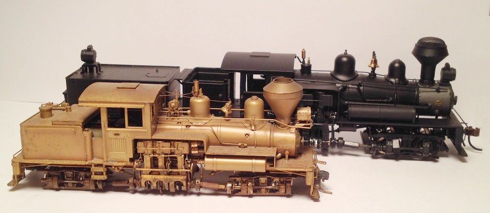

I don’t know if it really is too big?!? As 80 ton Shays was built for narrow gauge as well.
A comparison between the Shay and a K-27
And if we look at a pic comparing a 25 ton ng Shay with a bachmann Shay:
http://i3.photobucket.com/albums/y60/ThunderMountainRR/IMG_1700ed.jpg
I guess a 80 ton would be much bigger…
