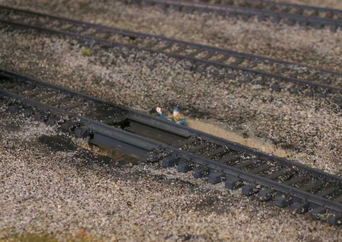

This is a mixture of WS fine grey blend and some “coal” which is very fine.
It looks a bit darker and finer in “real life”.
Ash Pit
This may be a bit coarse for what you are looking for. I’ll be adding more black and sandy spots here and there. Some washes would probably help too.
Any other photo posts would be helpful.
