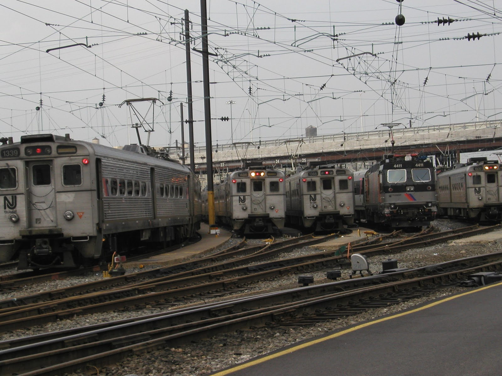

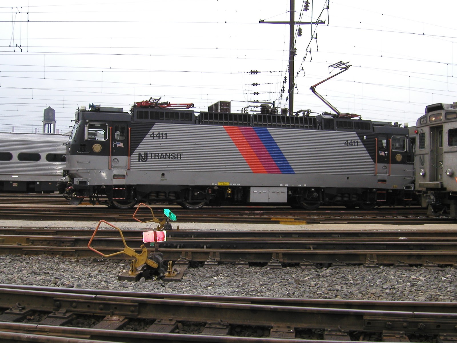

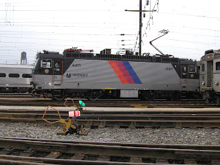

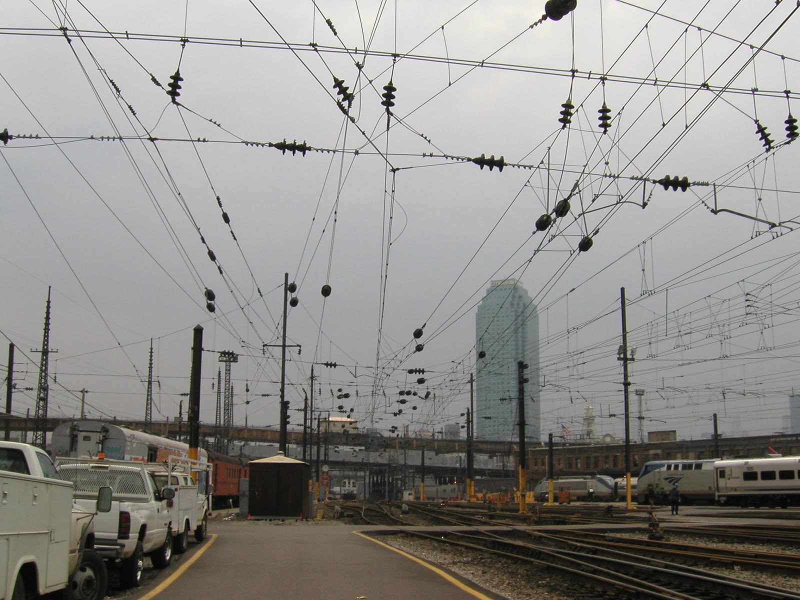

The train yards I have worked at or visited all had ballast as a way of keeping the tracks in place. Pictures below are from a visit to Sunnyside Yard in Queens NY. Note asphalt roadways and crossings.
Good Luck on your Yard
