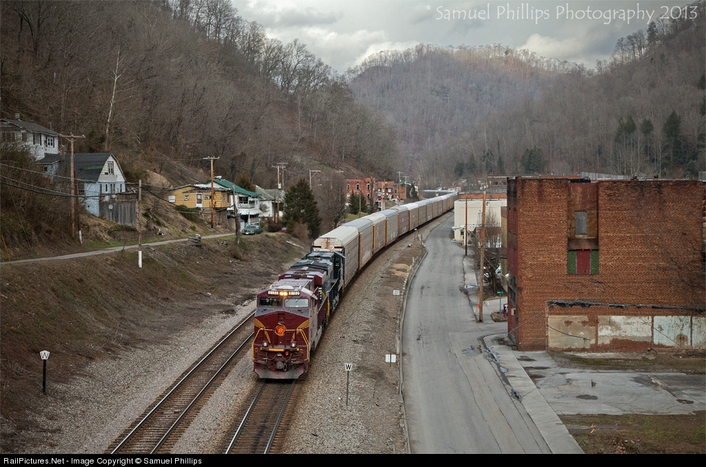

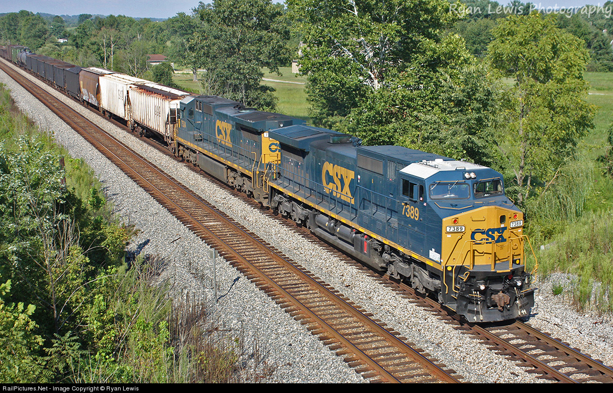

Just to make you feel better, I’ve been looking at a lot of RR photos lateley focusing on track and ballast, and realizing that in the real world ballast isn’t always that neat-looking either. Plenty of it gets into the “landscape” even when it is pretty newly laid.
That said, after testing with with WS medium and fine ballasts and being dissatisfied I decided to go with Scenic Express #40 natural stone ballast. I am starting with the blended version and its a little darker than I like (may get some light grey and try that next) but I find it works a lot better than the WS stuff. It is heavier and stays put, and smaller than the WS medium ballast which looks too coarse to me. Also unlike my first layout where I used detergent to wet the water/glue mix I am now soaking it down good with alcohol before applying the glue. Much better results.
As for the order of things, trying to figure that out myself. I’ve decided that the best time to ballast is after the base scenery is in place, and to paint the rails is after the ballast is applied using an airbrush. That way I can also get good staining effects on the ballast and ties on either side of the rails. Of course if there are trees and structures in place it makes it rather tough to get to.
