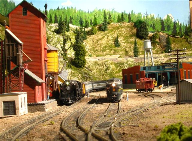

Most digital cameras have an optional setting for use with fluorescent lighting, and do a good job of correcting the colour balance. The photos below were taken under room lighting only.

Here are a couple of images that should help you to judge for yourself if multiple shadows and light spots of significant intensity are problematic. The first was purposefully done in such a way that the foreground is highlighted by the closest GA10, while all the others in the layout room are aimed as they usually are, somewhat convergent and parallel, but certainly overlapping.
Here is a different shot with the five lights spaced as I normally have them and all in their normal aimed positions…the two outer aimed outward to cover the corners. No other lighting is present, and the image is merely cropped. It isn’t the best sort to judge by, but I think the visible shadows are sufficiently clean-limbed to pass for realistic.
So that you can get a sense of what is where, here is a shot taken one night from outside the basement, through the window. You can see the one track high in the image, while the second is to the right, perhaps by 4’, obscured by the window frame. Clearly, there are some duplicated shadows, but I can control that to a significant extent with convergence and with juxtapositioning of two or more light fixtures…they’re easy to relocate…takes seconds.

Nice views, Crandell, particularily the second one. Your post reminded me that I had neglected to mention that one of the main drawbacks of fluorescent lighting is that the light is very “flat”, with generally no distinct shadows. This “flat” light also tends to hide a lot of detail, although a digital camera seems to be able to pick it up anyway. The drawback to that is that you sometimes get pictures like this: (you’ll need to click on the photo to see this best) [:I]
The cobweb on the loco wasn’t visible when I was taking the photo, and it was even difficult to see when I went back to clean it up after seeing the photo. Most of the pictures that I posted here earlier were looking south on the layout, meaning that the subjects would be backlit, so the lack of distinct shadows doesn’t really concern me. If I do want shadows for a picture, I hang a “trouble light” from the drop ceiling, situating it where the sun would logically be in relation to each particular scene.
[(-D] Been there. I had a nice image of my Niagara all composed, tested, a few samples, and then I took what I hoped would be the final postable one. One good look in this properly focused image showed…NOOOOOOO!! Silk all over one corner of the pilot.
Thanks for you generous compliment, Wayne. I know I have a way to go, including making my entire layout more detailed and credible, but I have to take the steps necessary to educate my brain and eye. Your own images, Charlie’s and Joe’s, and Jon’s, and about 10 other regulars here keep showing me why I have to keep working at it.
BTW, that is still a killer photo.
