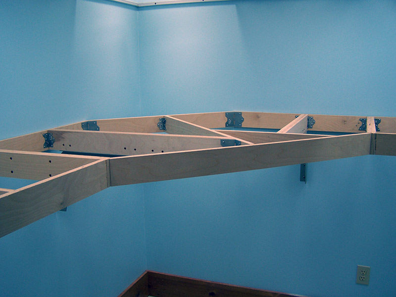

24" deep benchwork sitting on 18" long brackets. Rock solid. More pics at http://www.lkorailroad.com/category/benchwork/
30" deep benchwork sitting on 24" long brackets. Also rock solid.

Alan…your setup is the effect I was going for. Floating shelf, no legs. In the future I would consider adding a second shelf. Much nicer to look at without those pesky legs in the way. Will have a look at your blog later this evening.
