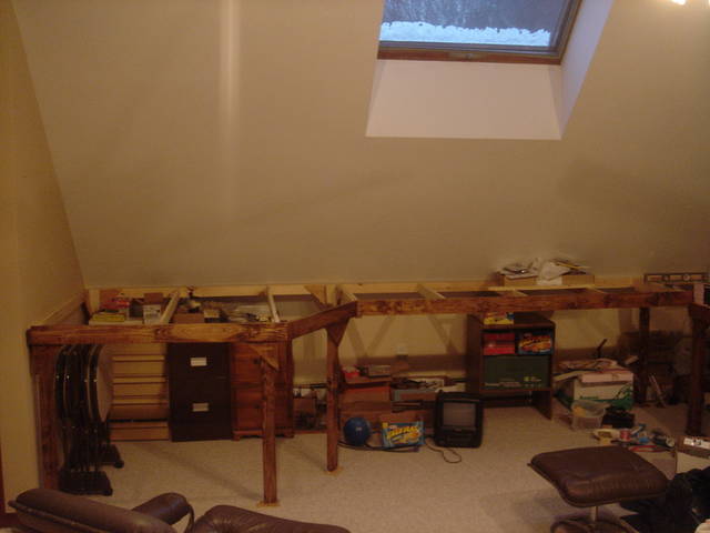

This may give you some ideas. I have a 45-degree roofline in my train room. I have an existing free-standing 5x12 foot table layout, and I wanted to connect it to a new section. I gave some thought to attaching the bencwork directly to the wall, but it seemed like a more difficult job than simply building more free-standing tables.
It’s simple construction. I used 1x4 pine for the front face, and 1x3 pine for the rest. The layout base is pink 2-inch foam, which sits on top of the frame and is protected by the extra inch of wood on the front. I stained and polyurethaned the front face and the 2x3 legs before installation. I plan to slope the foam down at the edges so I won’t need additional fascia above the wood line.
I built this in 3 sections, and I’m keeping the sections physically separable as much as possible, by putting track breaks at the seams and designing the track plan so I don’t have turnouts, etc., that cross between sections. It’s not meant to be portable, but if it ever does have to be moved, it will be possible with some effort and minimal destruction. The section at the left is 5-sided. It will have a lift-off section in the middle for access to the back of the layout. Off-camera to the right is a smaller 4-legged section. The center piece is just a box frame, and it shares legs with the two end sections for support.

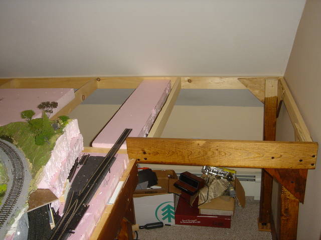

This is a detail of one back corner. I used triangular gussets made of plywood to support the legs. I found that this gives very good stability without having to build bracing beneath the layout, so I can get under the layout easily.
