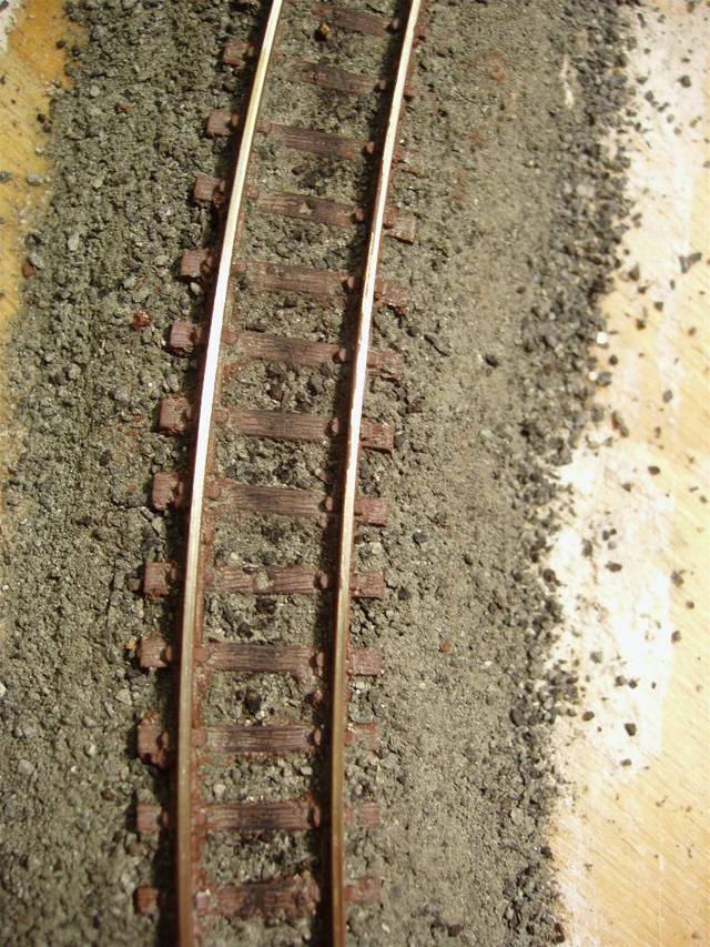

I regret having laid code 80 even after Atlas code 55 was available. I guess I convinced myself that I couldn’t lay code 55 well enough or that somehow code 80 would survive train shows and moves better… All rubish.
So, when I take pictures like this:
I cringe when I see that rail and the oversized ties. I’ve started stockpiling code 55 for a full track re-lay.
