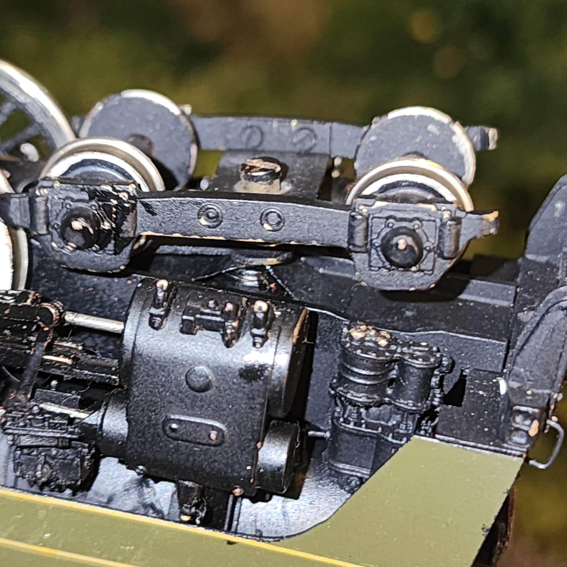

I recently purchased my own Brass engine for my layout. It is an HO Scale Brass Canadian National K5a Hudson model from Samhongsa. For some reason it’s front trucks began to suffer from details when it starts going around a curve. Mainly it happens when the model goes around my oval track in clockwise direction. I did some observation and found that the front driver wheels seems to wobble; the front drivers might be getting picked up by that wheel, and that could be the cause of it derailing, even on 26" curves.
It’s my first time servicng a brass engine in over five years. The wheels are in their normal three o’clock position, and no gears or piston rods are getting locked up as far as I can tell. Just that it needs some quick lubricating and the wheels to be cleaned. How would you go about fixing a wobby front driver wheel? And have you had an issue similar to this that could be useful?

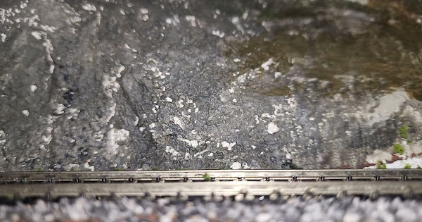

Here is a Google Drive link to a slow motion video of the derailment happening in action. This is the first time a derailment is happening like that; it can’t be the track since none ofnmy other similar steam models has that kind of issue.
So the front part of the front bogey jumps off first, than the rest follows after. Another issue is that this derailment doesn’t happen on some occasion. I say 65/35 the derailment happens.

  1. Check the gage of the wheels with your NMRA wheel gage

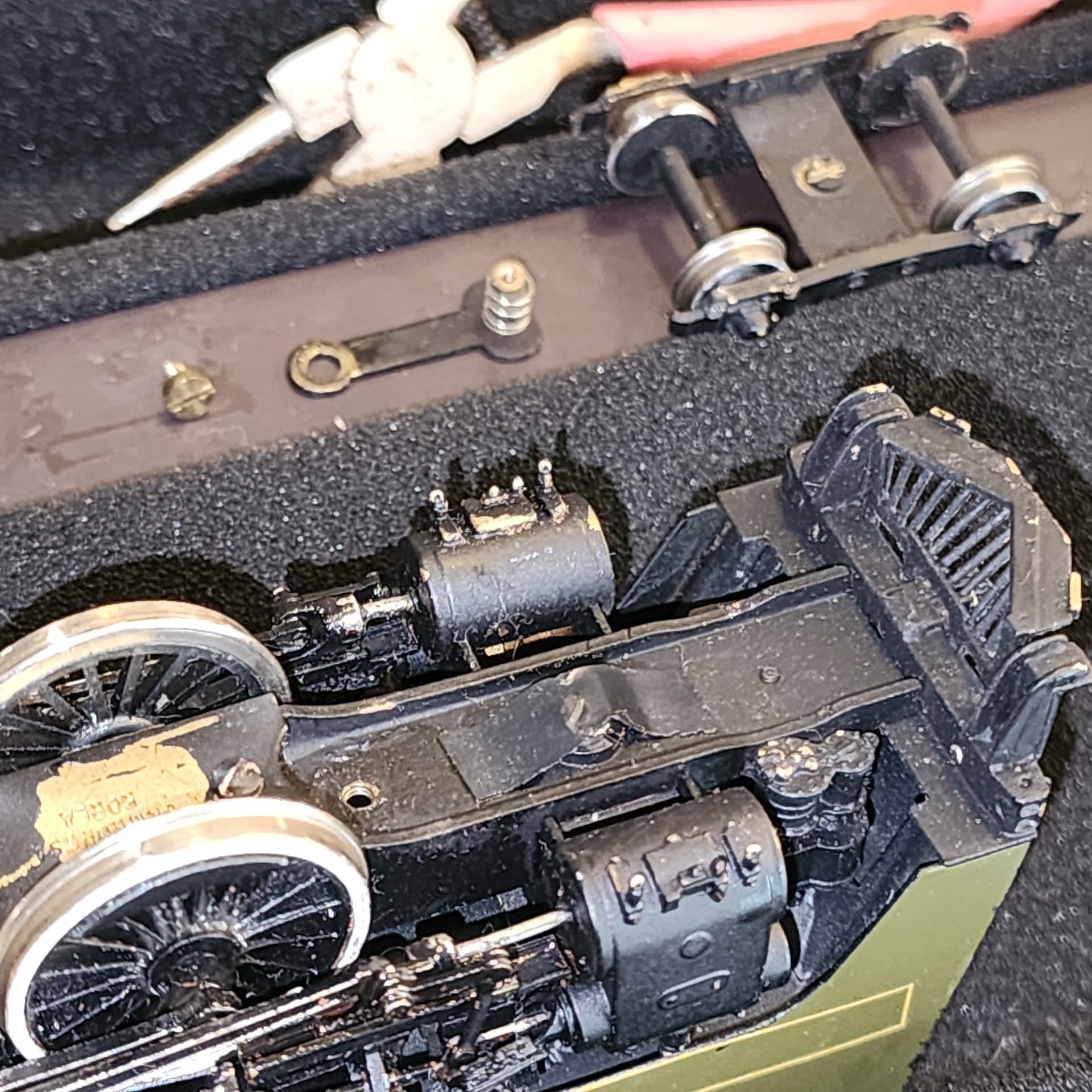

  2. I can’t really clearly see in your disassembly cradle pic but it looks like one wheel flange is nicked or chewed up.
  3. I noticed the truck frame is screwed together. The truck frame screws could be loose and the frame moves laterally too much causing the axle point to fall out of the side frame journals.
  4. I noticed a lot of paint ware on the engineer’s side steam cylinder [top in picture] I’m wondering if the cylinder cast is not allowing the truck frame to move side to side enough.
  5. run the pilot truck with your finger through the derail spots on the layout and see and feel what happens.
    Just some thoughts. Good luck!
