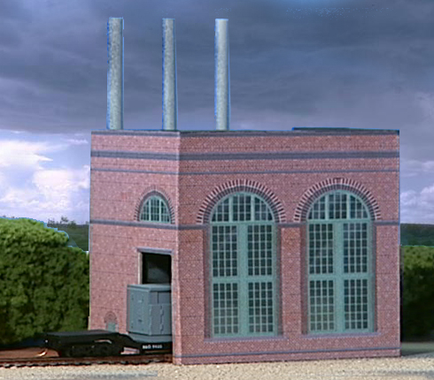

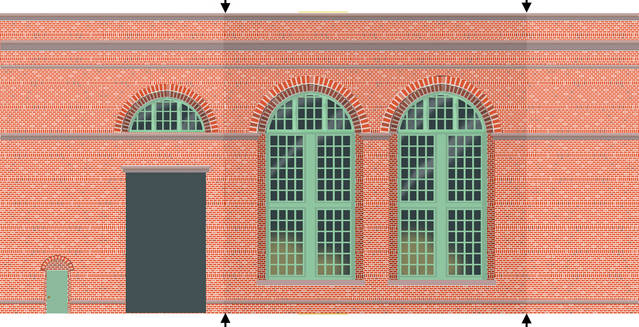

One possibility is to draw your own brick paper in a drawing program such as Photoshop and print it out. I drew up this one in Photoshop Elements…
I emailed this file to someone who wanted a model, and assembled a mockup to show what it should look like.
The printed file had printed windows. But you could use model window castings, copy them full size, insert them into your 2D picture file. After printing out the wall surface, cut out the printed windows and replace with same-size modeled windows, as described in Model Railroader May2011 p.30.
