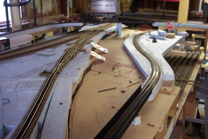

Bridge Advice
In this picture, the back track will be hidden behind a mountain/hill, and between there and the existing Truss bridge will be a Micro Engineering Viaduct. I don’t really like the single curved track on the double truss bridge and feel the size of the truss bridge will take away from the viaduct, so am thinking of replacing the truss bridge with a single deck girder bridge. Looking for opinions…
Personally, I’d get rid of the straight section through the truss bridge, go with a full curve and use a trestle. The curve through the bridge doesn’t look right. Or, you might try narrowing the “gorge” at that point so you have a shorter straight bridge, like the girder you’ve suggested.
Thanks. Thinking of narrowing the crossing there and using an Atlas Plate Girder bridge flipped upside down with ballasted track over it which would allow a slight curve like this:
I have several of that exact same bridge on the existing part as well as for the planned future part of my new layout and I can say without hesitation that bridge does not work in the location where you have it shown in the picture. A prototype would never have a curve on a straight bridge. How would you support the track?, how would you work in the bridge abutment? If you could move the bridge back farther and possibly use a ballasted deck bridge or an skewed plate girder bridge as seen below.

Aralai, the bridge you’re using will work just fine, but to make it look more realistic, some surgery may be needed. the track through the bridge should be replaced with bridge track that uses longer and more closely spaced ties, and the curve should be continuous. The stringers (or whatever you call the longitudinal beams under the track) should be located under the rails, and the trusses should be brought closer together.
My main issue is the size of the truss bridge in the foreground taking away from the viaduct which will be behind it. I have another spot on my layout where I can install the truss bridge with a parallel double straight track, and now that I understand the prototypical reasons for installing that kind of bridge, can make it realistic by making clearance the reason for installing there - probably a road. Thanks for the advice!

Obviously I COULD make the truss bridge work in the place it is, and even justify it with some prototypical examples and reasoning, however as my main reason is to draw attention away from that track and more to the track behind, I think it will also be easy to justify the smaller bridge based on what you guys have told me. Realistically, with the river size I have, and that it is neither navigable, nor prone to flooding, the railway would probably not have built a truss bridge, and certainly not a double track one for a single track.

Hope you don’t mind… I took a few liberties with your plan…
By moving the river around a bit you can accomplish a few key things. First, the linear nature of the river will help camouflage the circular nature of the track plan. This will help maximize your illusion of distance.
Second, by running the river from the mountain on the left to the town on the right, you get a better feel that railroad is “going somewhere” too. You could even tinker with the idea of including some sort of port scene in conjunction with the town.
Here’s an important one, you can now shift the smaller, less impressive bridge “down stream” to the right a bit, to get it out of the way of the larger more important steel trestle. It will also have a more realistic view, where it could be imagined that the low line is a competing railroad sharing the valley with the high line, or, perhaps the low line is the original alignment of the railroad, and the trestle represents a later “grade reduction project”…
Your double track truss bridge can be located over on the right side, where the river “escapes” to the sea beyond the benchwork, so you can utilize “existing assets”.
Now, the best part… you have a wonderful stream bed to detail with rocks, trees, fishermen, what have you. I get the impression that you’re looking forward to having fun with your scenery as much as you’re looking forward to running trains. It will be a lot of fun to work “on the water.”…
Let me know what you think?
Lee
Thanks Lee! I don’t mind at all! It is a very good idea and I like it a lot. The only issue I have is that because of my original plan, the section where the river is planned now is a drop down from the benchwork on either side. I’m not sure that is really a show-stopper, since it seems like a river doesn’t really require a huge valley, but I’m not sure how to deal with the valley which will have a fairly high viaduct, and then allow the river to flow to the right where the benchwork is higher…
